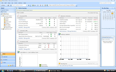

I was just playing around with Outlook and AX trying to see see if the Role centre could be got into outlook as a default homepage. Well the simple way is to add the EP link as the defailt homepage , but it didnt look to good , with the menu etc. However if you append '&RUNONCLIENT=1' at the end on the EP RC URL, the menu's get chopped off and you see the Role centre real cool. Say if the URL is 'http://arijit:150/sites/DynamicsAx/Enterprise%20Portal/RoleCenterCEO.aspx?WCMP=CEU' then append '&RUNONCLIENT=1' at the end of the url [http://arijit:150/sites/DynamicsAx/Enterprise%20Portal/RoleCenterCEO.aspx?WCMP=CEU&RUNONCLIENT=1] and the heads of the MOSS/WSS site get chopped off. Pretty kool. See the screenshot below from my Outlook default homepage with AX CEO RC :)

Дык а чё тут удивительного. Ролевой центр - это обычная aspx страница, её можно отображать чем угодно. Аксапта в том числе - отображает её в специальном браузеро-подобном окне.
А так - прикольно конечно, с т.з. использования.
