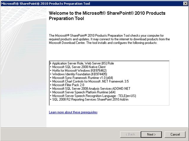

After installing SharePoint 2010 for the first time, I also have a suggestion for Microsoft regarding AX setup - please have a look at the SharePoint 2010 Products Preparation Tool (shown below) and incorporate this idea into the next release of AX.
