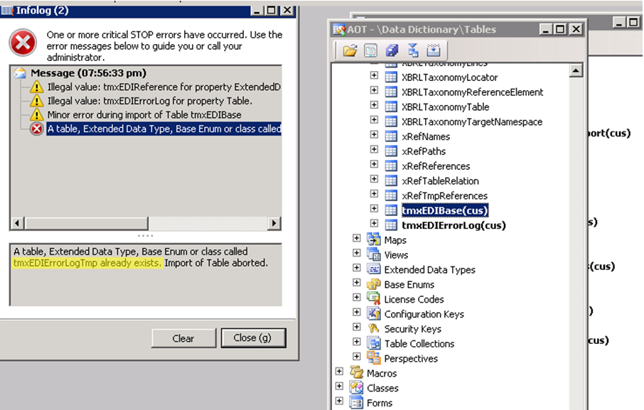

I bumped into a strange problem. The admin refreshed my development environment from the TEST one; consequently, all my objects were deleted.
When I started re-importing them from an exported xpo-project, a temporary table always caused the following error:
A table, Extended Data Type, Base Enum or class called XXXXX already exists. Import of Table aborted.
The problem can be easily resolved by flushing the user cache:
Stop AX client and delete all ax_*.auc files in "C:\Users\%USERNAME%\AppData\Local folder"
