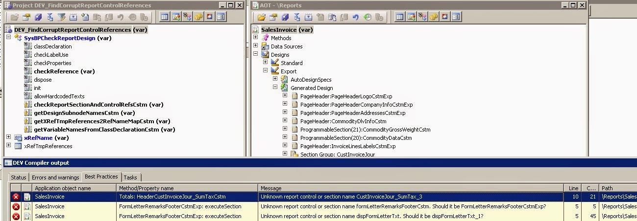

Sometimes new report designs are created by duplicating original ones. AX adds postfixes to cloned controls automatically to keep names unique, but should there be any references to report controls in the code (say, in executeSection methods), those must be fixed manually.
If this is not done, there will be no compilation errors, but the code in the new design will point to report controls located under the original design, which does not make sense at run time.
I have customized SysBPCheckReportDesign class to check if the code must be fixed in the new design. The customization is based on the standard cross-reference functionality. There was one issue with that: some report control names were cut in the xRefTmpReferences table, so xRefName EDT had to be extended. xRefTmpReferences table is not customized, but it is included to the project, as it should be re-compiled after the project is imported and data dictionary is synchronized.
You can find the XPO here.
And this is what the imported project and the new BP errors look like:
