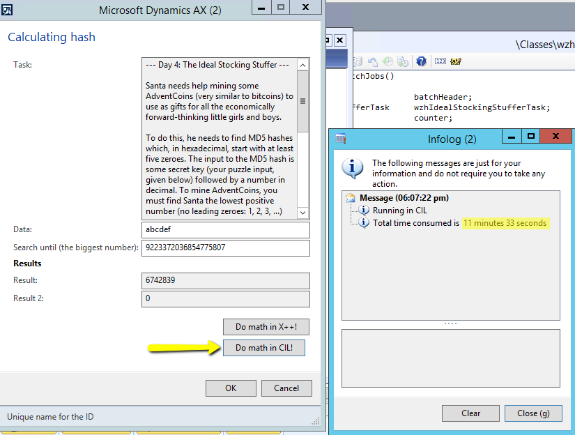

The stumbling point here was calculation time. Even for the first part of the puzzle, which is always easier than than the second one, it took so much time that I started flirting with the idea to improve performance.

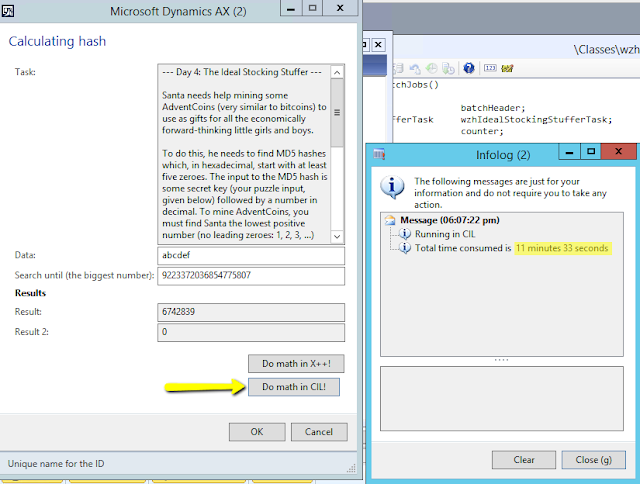

Wrapping the MD5 hash calculation method so that it could be run in CIL got it faster but not enough to be happy.

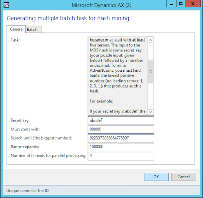

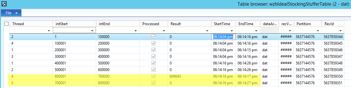

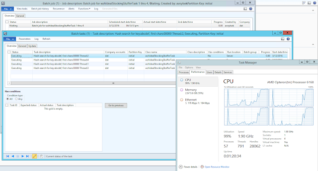

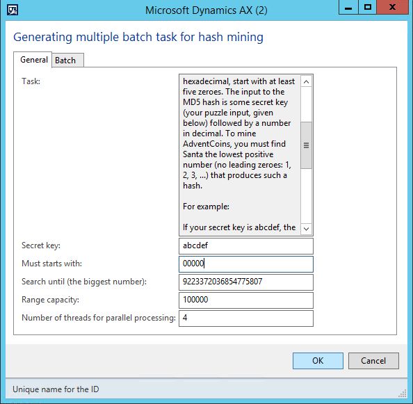

I created a table, which is to centrally dispatch creating, executing, and stopping batch tasks based on a separate, sequentially assigned positive number ranges. So, for each batch task it keeps the assigned thread number, ranges, execution status and found results, if any.

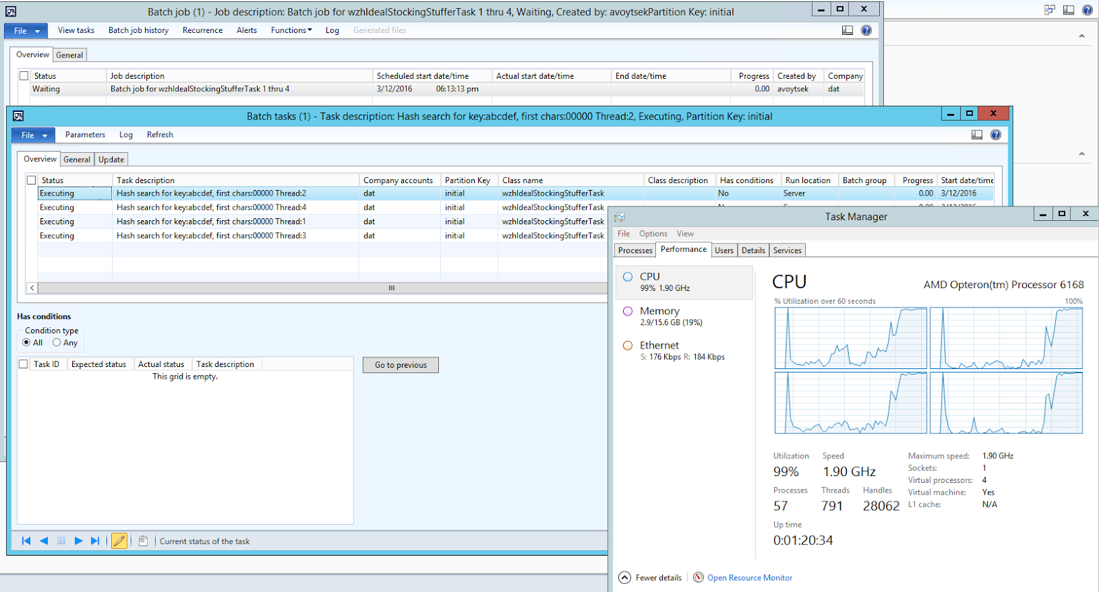

The batch task generating class creates them for a given number of logical processors, four in my environment.

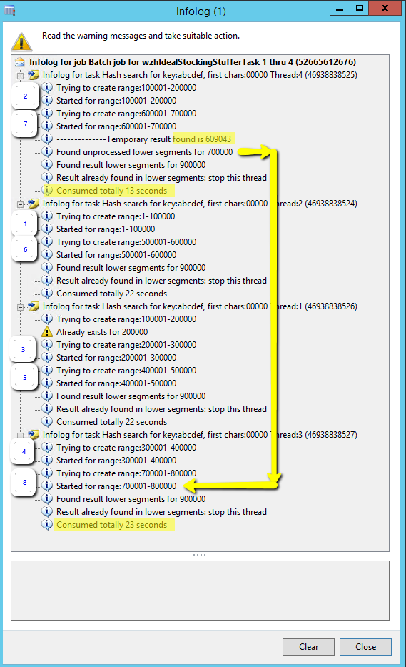

Each task checks the table for a found result. If it is already found in any range, it stops.
If not, it looks for the highest range from the table and than tries to add a new record. In case of success, it runs finding the lowest number in the given range.
If such a number is found in the current thread, this value becomes a new candidate only if there are no results found in the lower ranges and no any lower ranges still running.
Now blood runs faster: even the second part of the job did not give me a pause to get another beer from the fridge.
However, it is up to your judgement to set up the right range size and number of parallel tasks. The smaller a single step is, the more the transaction cost will be. And vice-versa, the larger the range is, the longer you need to wait the higher ranges tasks to finish: the total execution time is the longest task's.
