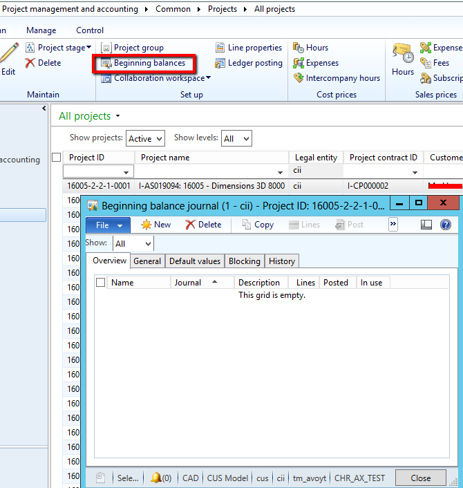

There is a bug in AX 2012 R2/R3.
Beginning balance journals do not create transactions in ProjJournalTrans table; therefore, they won't be selected via the standard query.
This is a small fix to show beginning balance journals from the projects forms.
In ProjJournalFormTable class we need to redo datasourceLinkActivePre() method as follows:

// if this is a beginning balance table we have no transactions in ProjJournalTrans
// therefore, we need to update the query so that all related journals will be shown.
if(journalTypeId == 2) // beginning balance
SysQuery::findOrCreateRange(journalTable_ds.query().dataSourceTable(tableNum(ProjJournalTable)), fieldNum(ProjJournalTable, JournalType)).value(SysQuery::value(ProjJournalType::BegBalance));
SysQuery::findOrCreateRange(journalTable_ds.query().dataSourceTable(tableNum(ProjJournalTable)), fieldNum(ProjJournalTable, ProjId)).value(SysQuery::value(callerRecord.ProjId));
