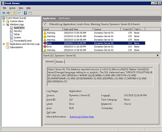

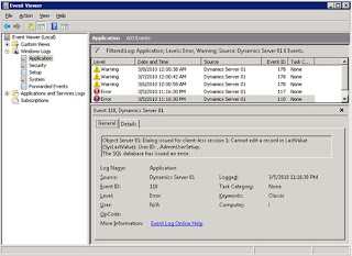

I observe the issue described below in both AX 4.0.x and AX 2009 SP1 x solutions running SQL Server 2005 and 2008 (the version of SQL Server Native Client is the same). This is also reported by others in several Communities like microsoft.public.axapta (last one beeing a post by Mike titled "AOS errors" from February 25 2010 where one suggestion is to syncronize the SYSLASTVALUE table).
Eventlog, application
#1 Event ID 110
Object Server 01: Dialog issued for client-less session 1: Cannot edit a record in LastValue (SysLastValue). User ID: , AdminUserSetup.
The SQL database has issued an error.
#2 Event ID 117
Object Server 01:
The database reported (session 1 (-AOS-)):
[Microsoft][SQL Native Client][SQL Server]Changed language setting to us_english.
The SQL statement was:
"UPDATE SYSLASTVALUE SET VALUE=?,RECVERSION=? WHERE (((((((USERID=?) AND (RECORDTYPE=?)) AND (ELEMENTNAME=?)) AND (DESIGNNAME=?)) AND (ISKERNEL=?)) AND (COMPANY=?)) AND (RECVERSION=?))"
I don't know if this has any impact on the solutions at all and I have also found some information on Partnersource describing this as "noice". And I also find it a little bit hard to understand why a syncronization of the system table SYSLASTVALUE should be needed since the real error message in fact is stating "Changed language setting to us_english.".
The reason for posting this is that I find it a little bit hard to understand why something is logget as an error situation if this is "just noice". AX is in general bad at categorizing events in event log application, but I would like to share some experience with others regarding this. Since it's reported from the ODBC layer it could be related to settings like default language for the DBO user (aka AOS Service Account) or inproper settings for Regional Settings for the same Service Account. This is a couple of my own teories left to verify, but bottom line I find it hard to be "just noice".
