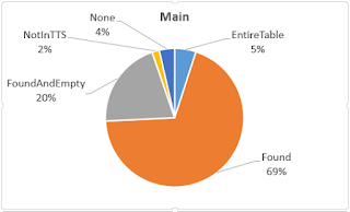

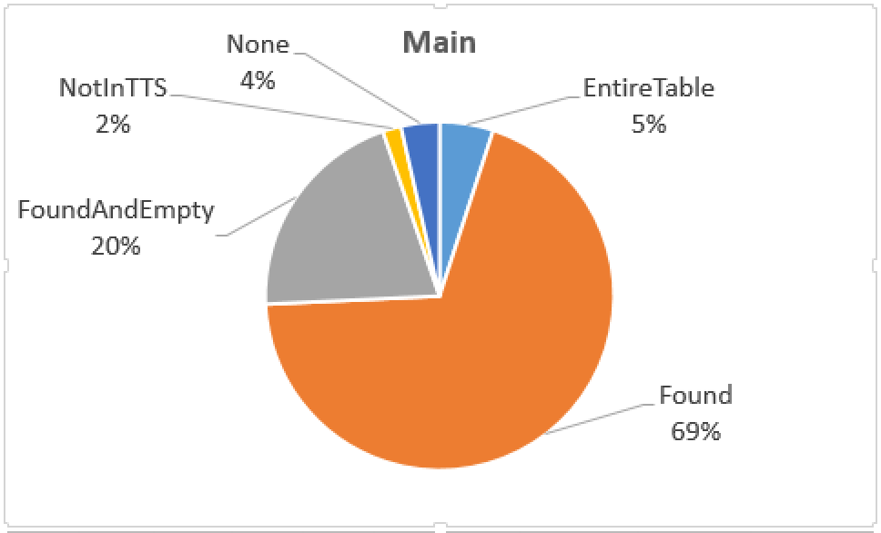

TableGroup Main
The suggested value is Found and it is very true in standard AX. Together with FoundAndEmpty it is impressive 89% of all Main tables.

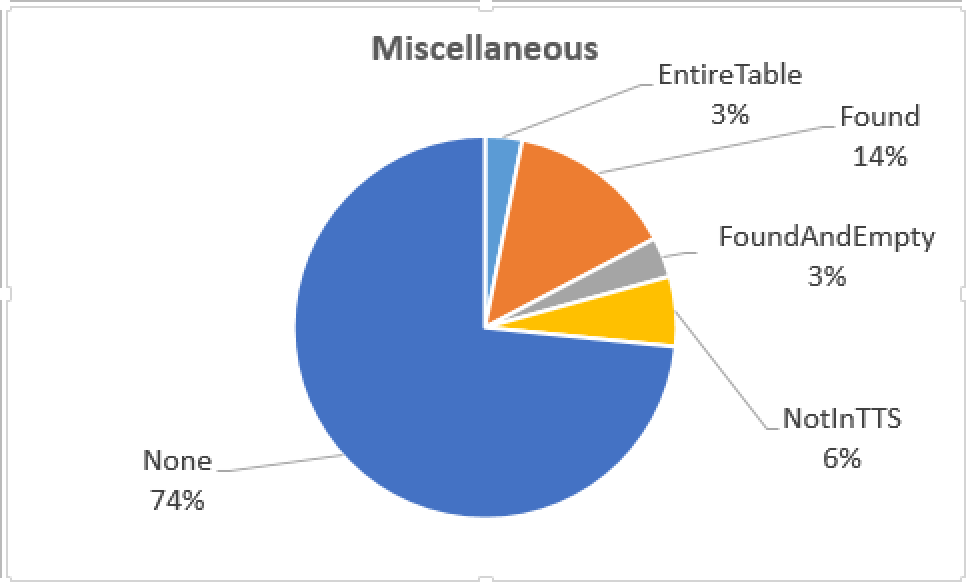

TableGroup Miscellaneous
It is suggested not to use Miscellaneous in TableGroup, however there are quite many of them in standard application. I guess it was not easy to define TableGroup for these tables as well as CacheLookup value. 74% of all Miscellaneous tables have None in CacheLookup.

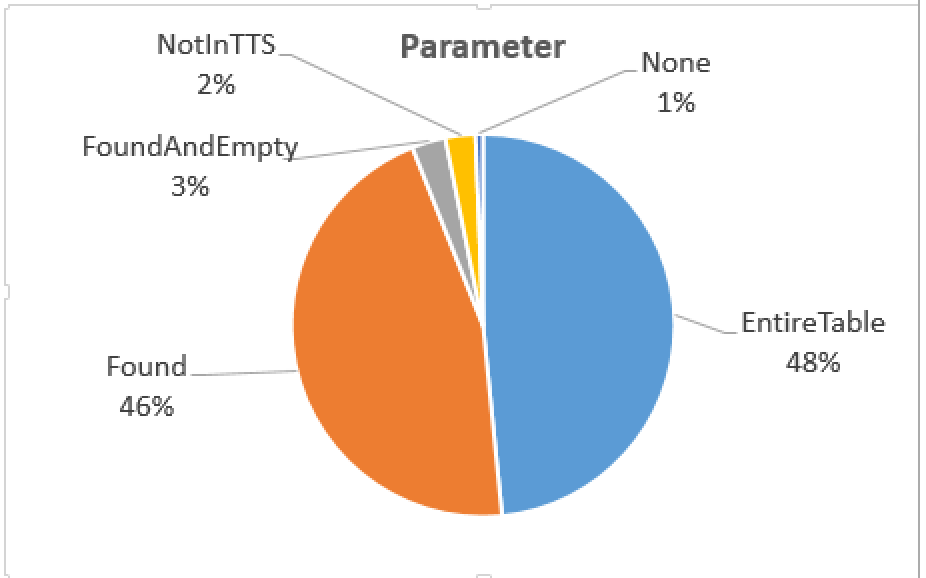

TableGroup Parameter
The suggested value is EntireTable and it is quite true in standard application. It is not clear why 46% of Parameter tables have Found in CacheLookup, it should be better set to EntireTable.

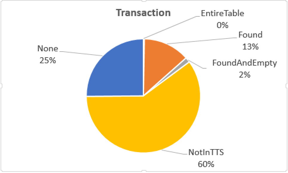

TableGroup Transaction
The suggested and actual values are the same - NotInTTS.
Note: None is set on 25% of Transaction tables or 281 tables.

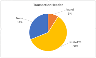

TableGroup TransactionHeader
The suggested and actual values are the same - NotInTTS. 31% of tables or 14 tables have None.

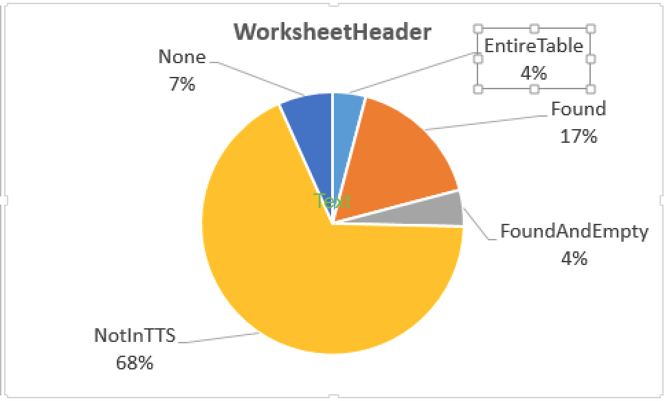

TableGroup WorksheetHeader

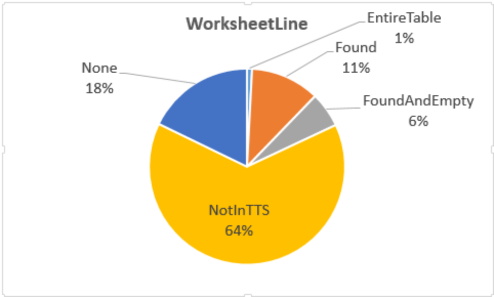

Note: 18% of WorksheetLine tables or 86 tables have None in CacheLookup.
