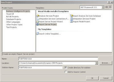

  • Launch Business Intelligence Development Studio.
  • Create a new Report Server Project.
  • In Solution Explorer, right-click Reports folder, and click ‘Add New Report’. A Report Wizard will open up. Click next on the first introduction page.

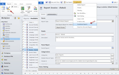

    Note: To edit exiting custom report created through CRM Report Wizard, select "Add > Existing Item..." above instead of "Add New Report". You can download your custom report from CRM, by selecting your report then Edit > Download Report.

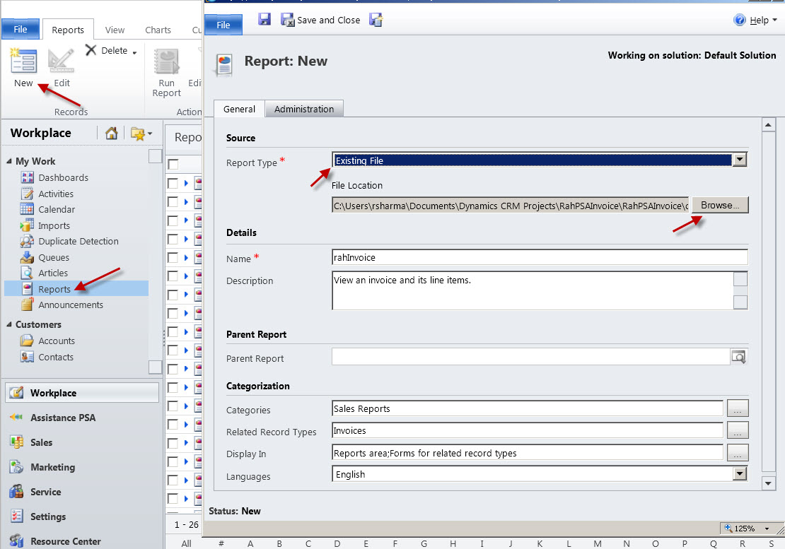

  • Now, upload your RDL on the CRM server in the appropriate categories and your report is ready to be displayed in CRM.
