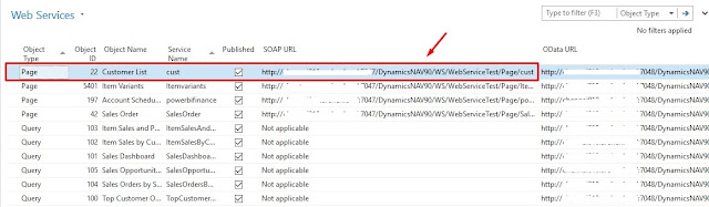

2. Add a New record, of Type Page and ID 22 and give a Service Name like cust.
3. Share the URL with the customer.
Now, what if the customer says, there we are unable to consume it to Read, Read Multiple and other web service functions what to do???
Let's discuss some of my findings.
What we do to start with is add record in web service page as shown below -

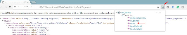

Next click on URL generated in Navision Web service Page, it will show something like this -

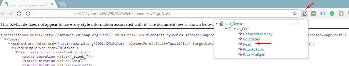

1. Open the Web Service URL in the web browser, it will detail as below.
2. When we open in Google Chrome, we can use Wizdler to access function that web service has as shown below. We will try to use Read function from cust web service published in Navision.

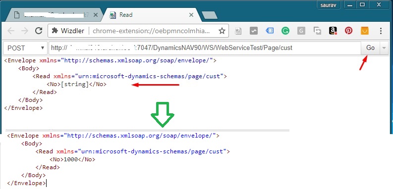

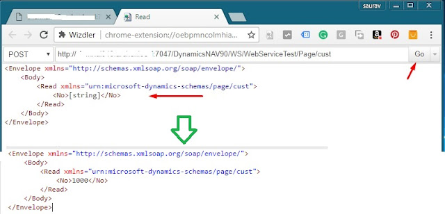

3. After selecting Read, System will open in a new tab, enter the parameter required by the web services. In this case, web services request No. Parameter and let's assign a number which exists in Navision.

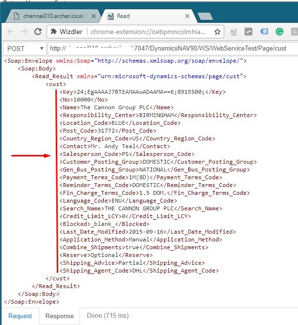

4. After clicking on Go as in above screenshot, the system will return all field value that is part of the Navision page web services as shown below.
