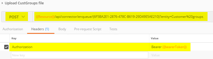

Open Postman, and execute the "GetToken" call to get the access token. Then create a new POST call with this url https:///api/connector/enqueue/?entity=
Activity ID is the job ID that was displayed when you created the recurring jobs.
Then click on the Body tab, choose Binary, and click the "Choose Files" button to choose the import file. After that just click the "Send" button.
If it's successful, it will return with a job ID and HTTP 200.
