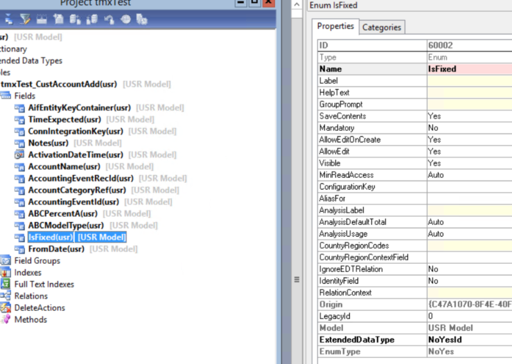

As you can see from the following code, we have to get the primitive or container type for a given EDT. It comes from method AOTtpeStr() as an abbreviation. Then you should call an appropriate method to create a new field.

fieldNode = treeNodeFields.AOTfindChild(edtName);
fieldNode.AOTsetProperty(#PropertyExtendeddatatype, edtType);
fieldNode.AOTsave();
currentFieldGroupTreeNode.AOTadd(edtName);
info(strfmt("Field '%1' of type '%2' created", edtName, edtType));
