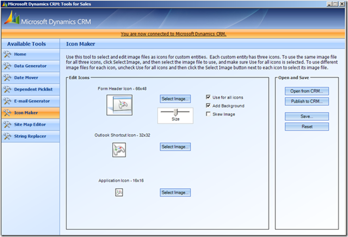

First of all, download the Demonstration Tool program, run the exe and click the link at the top to connect.
The box that pops up asks for the usual login, password etc. Once in, click the Icon maker icon to take you to the icon maker page.
Click on the first Select Image… and add in a picture. Then click the ‘Use for all icons’.
The image above is taken directly from Tanguy (saved me firing up my VPC). He has chosen to click the ‘Add Background’ box as well. I generally don’t but it is up to you.
If this was CRM 4, at this point you would click the ‘Publish to CRM…’ load up the icons and congratulate yourself on a job well done. No such joy for us CRM 2011 folk. We need to click the ‘Save…’ button. The usual file save box opens up and while it will give all indication that it is just saving a png file it will, in fact, save three files, with semi-meaningful names (‘application’, ‘outlook’ and ‘form’), for manual uploading to CRM.
