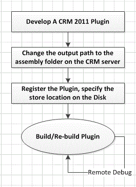

Now the Microsoft Dynamics CRM 2011 has been released, I'd like to guide you through an efficient development workspace for CRM 2011. The overall develop/build/debug process should be very smooth, see the following diagram:

Next, after you developed a CRM plugin in Visual Studio 2010, you may register it using the Plugin Registration Tool (can be found in the CRM 2011 SDK). Make sure you register the DLL in the Disk (during development/testing phase); Also change the project properties in Visual Studio 2010: change the Build | Output path to the CRM server assembly folder, i.e.:
\\CRM\c$\Program Files\Microsoft Dynamics CRM\Server\bin\assembly\
So each time you build the project, the new DLL and PDB file will be output to the assembly folder, CRM will pickup the new plugin DLL automatically without manually re-registering it.
If you get the error message when rebuild the project in Visual Studio: "Unable to copy file ... because it is being used by another process...", you may add the "Pre-build event command line" to recycle the CRMAppPool or restart the Service of the CRM server (See: Build a handy Dynamics CRM development environment).
