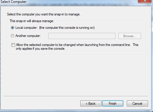

  • Open the Microsoft Management Console (mmc.exe)
  • Goto file menu and click on Add/Remove Snap-in (Ctrl-M)
  • Add Certificate (Select Certificate then click on ADD chose Computer account and then click on Next Button and then Finish)
  • Select Certificate and click OK

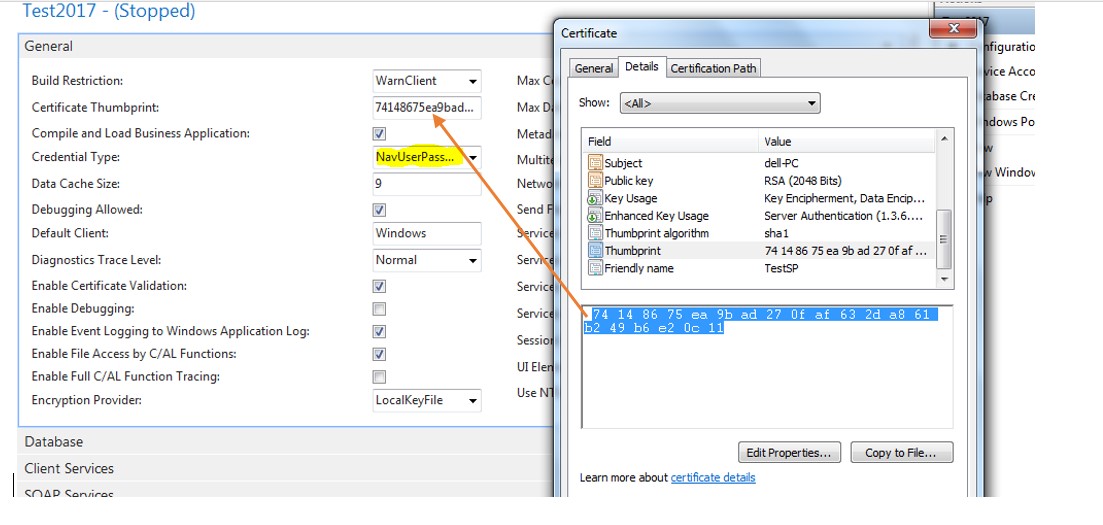

    • Update Certificate Thumbprint
    • Certificate Thumbprint is your SSL Certificate Thumbprint value
    • Note: - In the text editor, delete all spaces from the thumbprint string.
    • For example, if the thumbprint is ‎74 14 86 75 ea 9b ad 27 0f af 63 2d a8 61 b2 49 b6 e2 0c 11, then change it to 74148675ea9bad270faf632da861b249b6e20c11

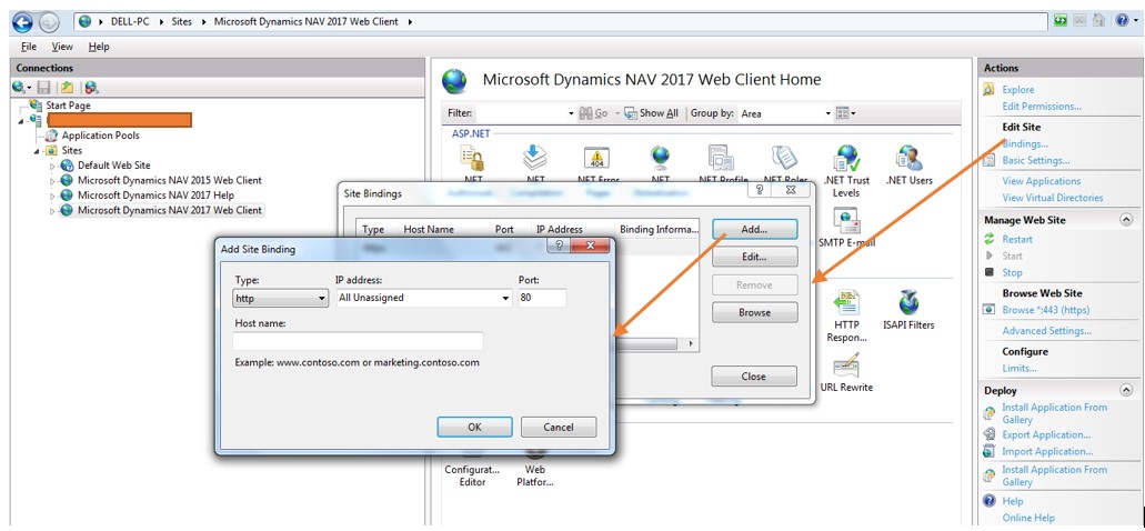

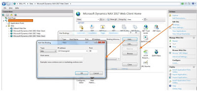

4.Setup Web Client (Add SSL Certificate)
  • Open Internet Information Services (IIS) Manager
  • In the Connections pane, expand the Sites node, and then choose the Microsoft Dynamics NAV 2017 Web Client
  • In the Actions pane choose Bindings
  • In the Site Bindings dialog box, choose Add.
  • In the Add Site Binding dialog box, set the Type field to https.
  • You can use the default port 443 or change it to another port. If you change it to another port, you will have you provide the port number in the URL when you try to open the client.
  • Set the SSL certificate field to the certificate that you obtained or created for the site.
  • Choose the OK button, and then choose the Close button.

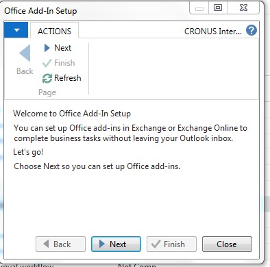

  • In Assisted Setup Page, Choose Set up Outlook for Financials.
  • Open Office Add-In Setup click on Next.

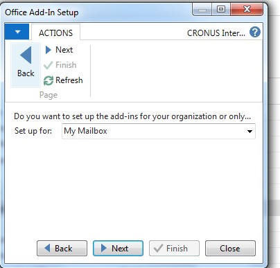

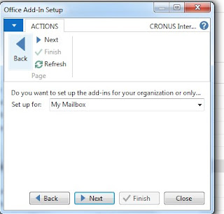

  • Select Set up For – “My MailBox” , then click on Next

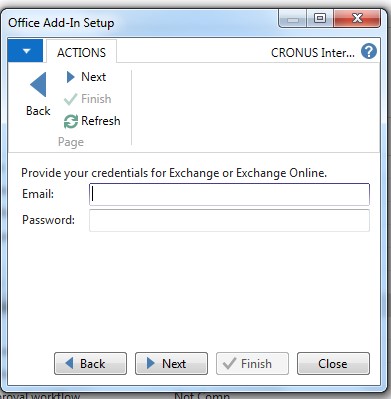

  • Now Enter your credentials, then Click on Next
