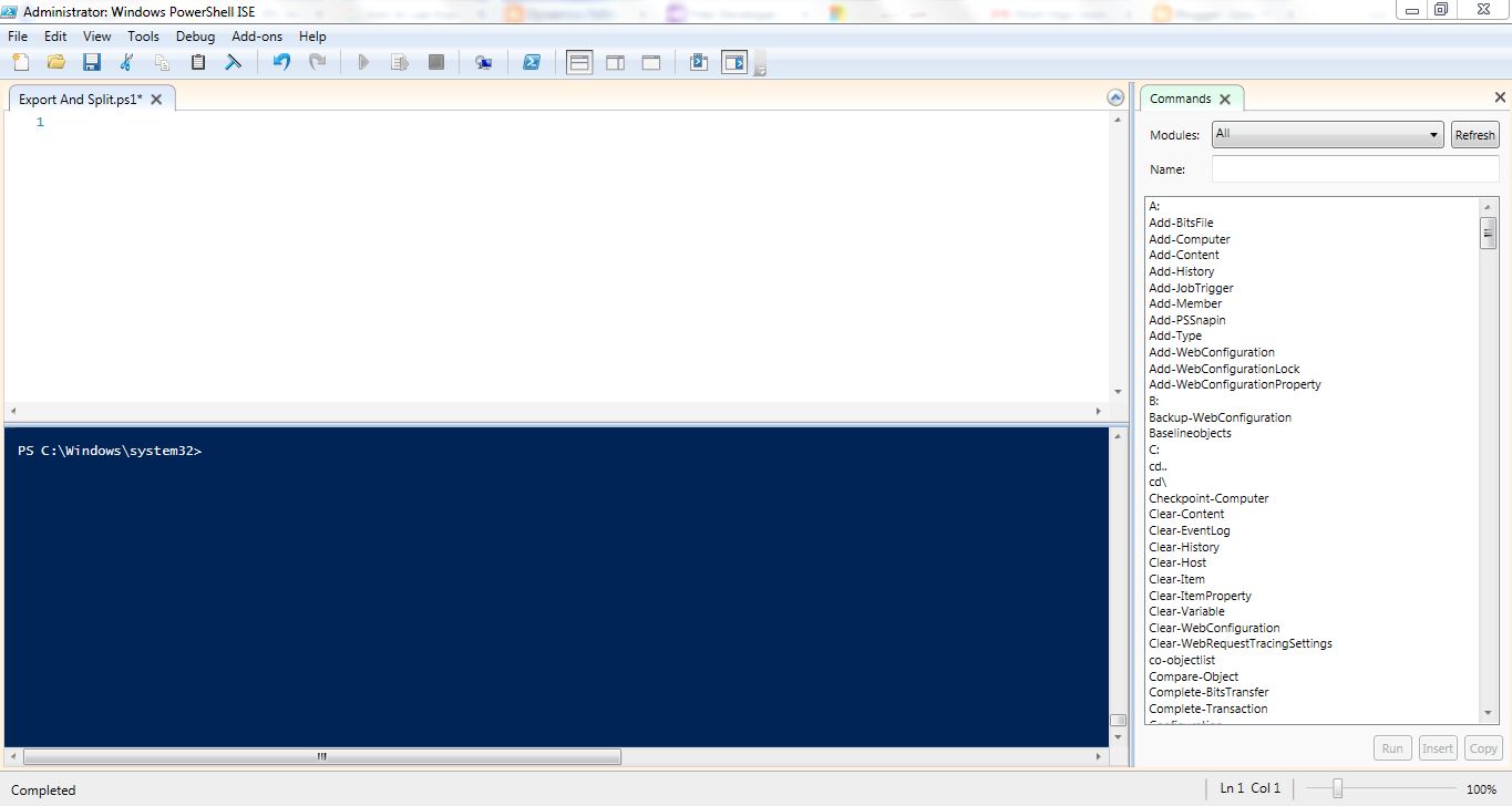

1. Open Windows PowerShell ISE and Load Nav Development Shell Command.
In Start Menu Just search Windows PowerShell ISE and open it.
Now you will see below screen.

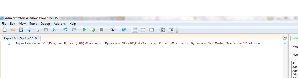

Now to load Nav development shell command into Windows PowerShell ISE just run below command then you access all function and command which are available in Microsoft.Dynamics.Nav.Model.Tools.Module.
Command :- Import-Module “C:\Program Files (x86)\Microsoft Dynamics NAV\80\RoleTailored Client\Microsoft.Dynamics.Nav.Model.Tools.psd1" -force
Run its command by using Run Scipt(F5) {Tools - Run/Continue}.

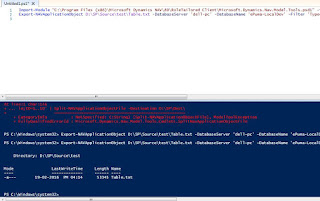

Now run the below command for export objects form specified Database.
Export-NAVApplicationObject D:\SP\Source\test\Table.txt -DatabaseServer 'dell-pc' -DatabaseName 'ePuma-LocalDev' -Filter 'Type=Table;ID=1..10' -LogPath 'D:\SP\Source\test\' | Split-NAVApplicationObjectFile -Destination D:\SP\Dest\
After run it command show the below screen.
Now can check specified path "D:\SP\Source\test\" in command then you found a txt file with specified name (Table.exe)
