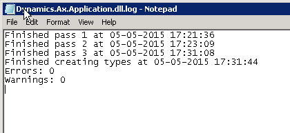

A quick way to find X++ errors after an unsuccessful fuld CIL generation is to look in the CIL generation log.
The log can be found on the AOS-server in the relevant AOS-instance's program files, e.g.
"C:\Program Files\Microsoft Dynamics AX\60\Server\[Instance name]\bin\XppIL\Dynamics.Ax.Application.dll.log"
You want the log to look like this
