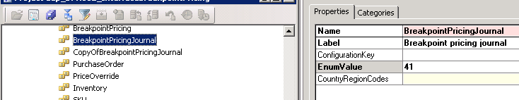

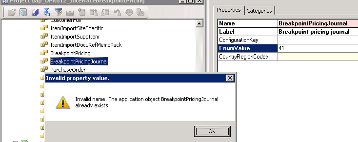

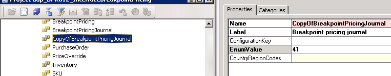

Bug in AX 2012 R2.
When you use drag-n-drop in AOT to create a new element for a enum, it creates this element with the exactly same value.
But all enum values must be unique.
It can lead to eventual errors in run time.
Please send a bug report to Microsoft.
