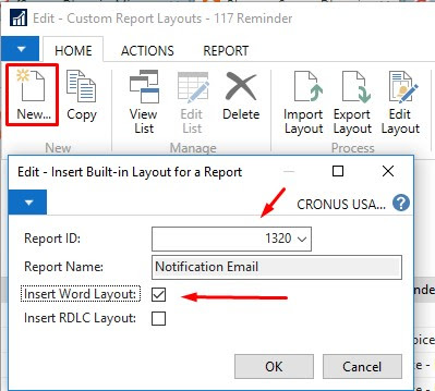

Step 5 - Click New to add a new record, specify Report ID = 1320 and Insert Word Layout to TRUE.
Step 6 - Select the Record in New page and click on Edit Layout from the Ribbon.

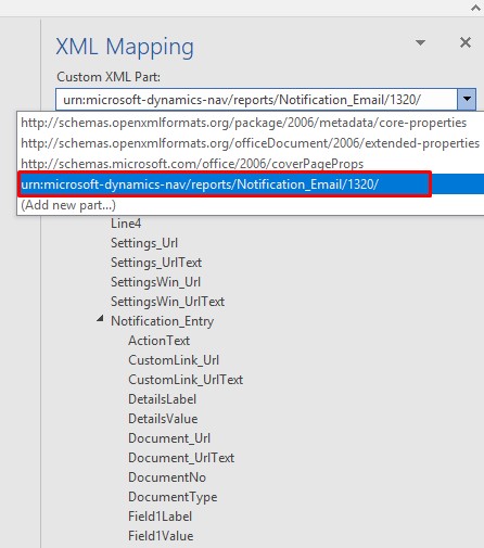

Step 7 - This will open Microsoft word for editing the word layout. From the Developer Tab, select XML Mapping Pane as shown below.
** If you don't see Developer tab you can enable that from the options.
Step 8 - Select XML Mapping and select the Custom XML Part that is with Report ID, as shown below.

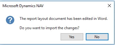

Step 9 - Once you are done with customizing the word layout, close Microsoft word and select Yes to import changes in NAV Report.
Changes should be available going forward.
