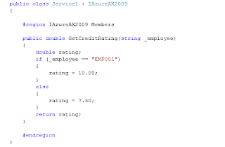

I created a very simple service which accepts employee code and returns the credit rating.

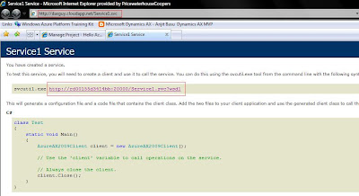

Browse the service by providing the service name on your browser. You will be able to see the service.
One important thing to notice here is that service name marked above in red.
svcutil.exe http://rd00155d3414bb:20000/Service1.svc?wsdl
This is something which will give you issues when you want to generate proxy using wcftestclient or svcutil and also with Dynamics AX :-). There is a hotfix available from Microsoft KB971842 . I could however not use this hotfix as I got an error while trying to install. Im on WIN 2008. Nevertheless the show must go on. My service was up in the cloud and I needed to now access it from AX.

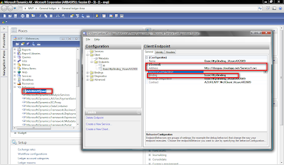

Well the workaround is to use your local service http://localhost:50026/Service1.svc to generate the proxy in AX 2009 and then configure the Service Reference using the MS WCF Service Configuration editor to change the service reference. See the screenshot below.
This will change the config file in the Service References folder in your AX 2009 Application Instance folder.

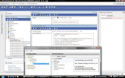

Now write some code to call the service. I created a small form where I pass an employee code and get the credit rating of the employee. Just to be on the safe side, I shut down my local IIS server just to ensure that I was really referring to the cloud.
The code sample is as follows in AX 2009.
And it was working. Really cool. I was consuming a AZURE WCF Service from Dynamics AX. There is a lot of potential in this. Maybe in next generation AIF , developers will be able to generate Cloud AIF directly from AX :-).

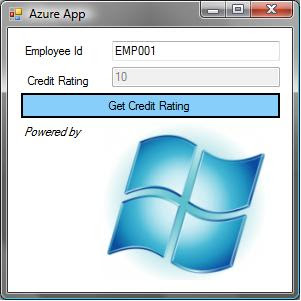

I had also created a Windows Application to test this out in similar ways and it worked nicely.
