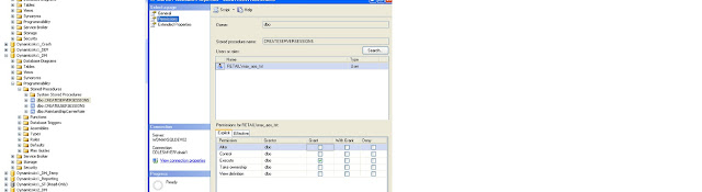

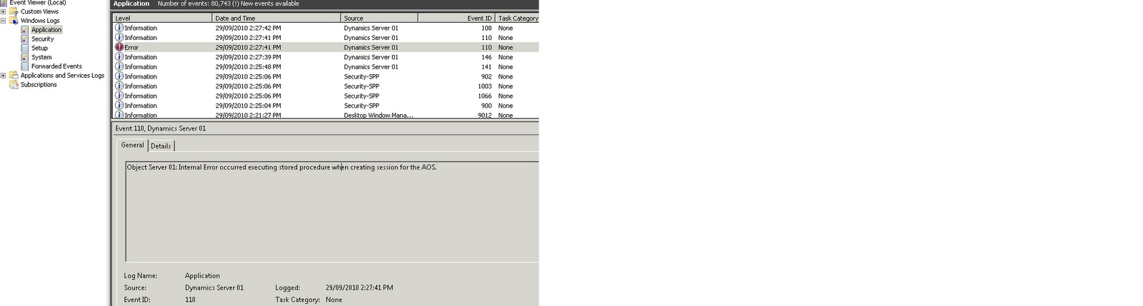

We were getting this error when trying to start the AOS Service after we restored an AX Database from one of our existing environments:
Error : Object Server 01: Internal Error occured executing stored procedure when creating session for the AOS

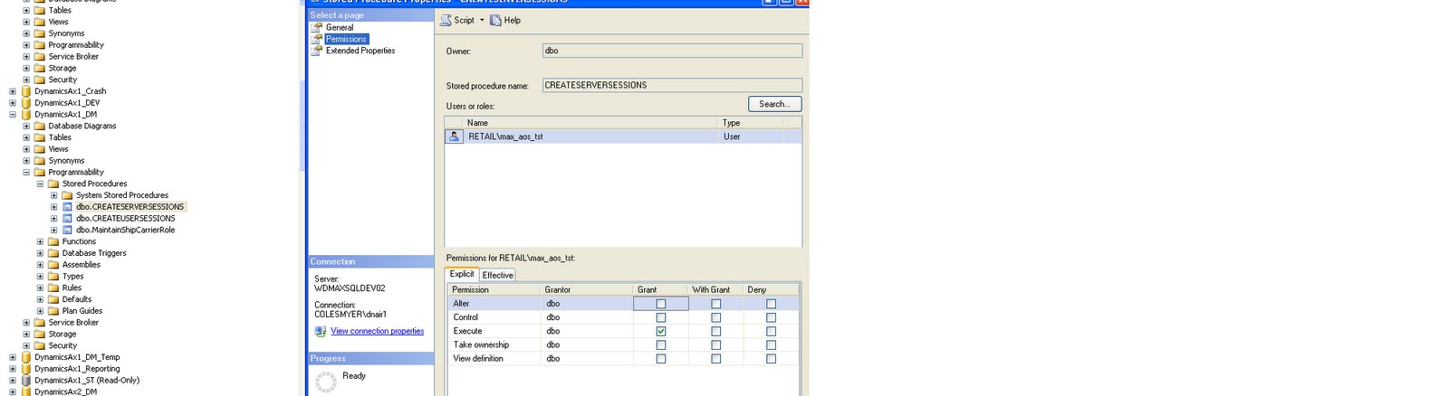

By seeing this error, I was quickly able to conclude that it has to do something related to the stored procedures which creates server sessions and client sessions, I compared the permissions of the sp's with our other AX databases and found that the aos service account didn't have "Execute" permissions on these 2 sp's and hence the errors, After assigning the permissions, we could start the service without any hiccups
