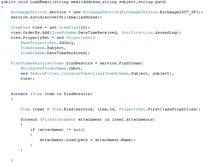

This is all the code which does the job:
a. Declaration
b. Logic for reading the email for a particular email address and subject and downloading the attachment
As you have seen the code above is very self-explanatory as it calls the Exchange Service proxy to do a FindItems for the mailbox folder (Inbox) and for a particular subject.
The next part in code is where it loops through the item collection and if it finds an attachment for the message item, it will download the attachment to the path supplied.
Limitations:
a. I tried to directly invoke the code from AX by adding the Exchange Service Assembly to the Resources node in AOT, but I'm unable to marshall the complex types and generics between X++ and .Net, Also the class ContainsSubstring is an abstract implementation in .Net which I'm unable to get a handle via X++, so I had to write a custom .Net wrapper and then call this from X++.
b. The X++ code which invokes my custom .Net assembly works fine without any issues if it's run via a job or class or menu item but as soon as I put it in a batch it doesn't work. It just fails without any error log.
If anyone has any ideas or have invoked custom .Net assemblies via a batch, can you throw some light
