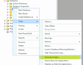

Navigate to the database you wish to migrate. Mouse right click, select task , then generate scripts.

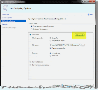

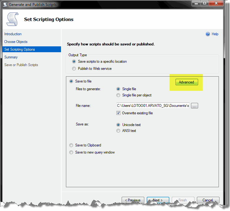

A wizard screen called "generate and publish script" will pop up. Select your object and define the script location. Key thing here is click the advance button.
Inside the advance option;
Set "script for the database engine type" to SQL Azure Database
Set "Convert UDDTs to Base types" to True.
Set "Types of data to script" to schema and data
Finsih...
