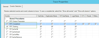

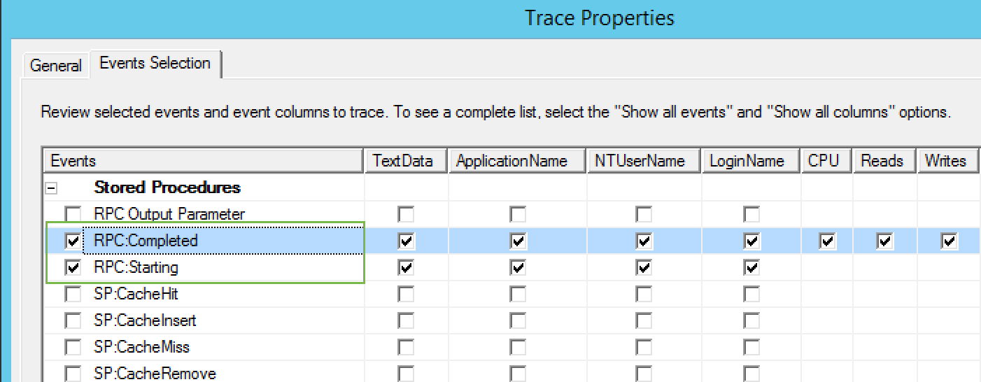

Setup SQL Server Profiler to trace RPC:Starting and RPC:Completed events:
