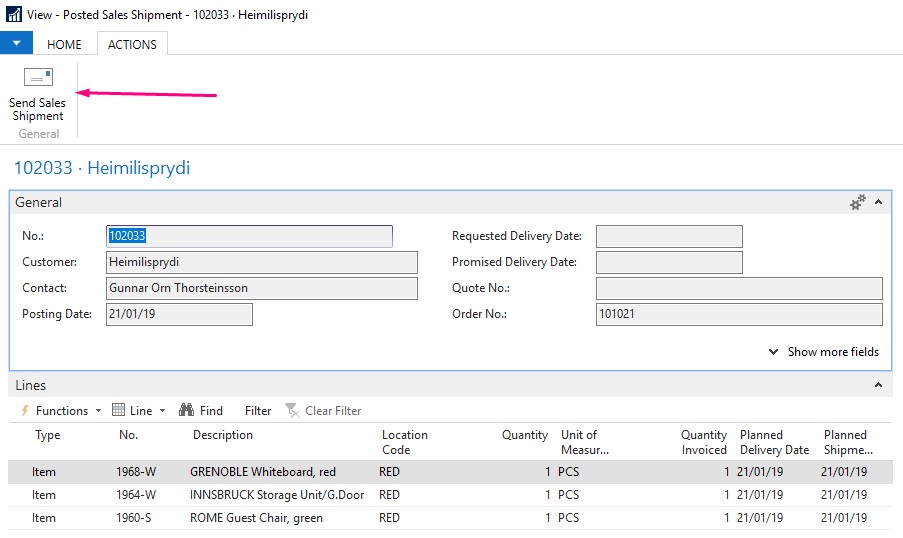

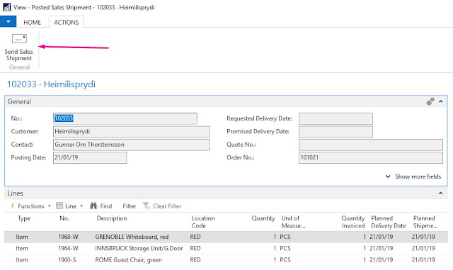

4. Add a function in Sales Shipment Page for Sending Email.
5. Here is the Email that is sent from NAV.
