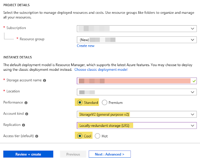

You will ned to choose a Resource Group, or create a new one. I typically have a Resource Group I put "DynOps" stuff in, like this Storage Account.
I want to make this a cheap account, so I tweak the settings to save money. I opt for only Local Redundancy and a Cold Tier. Perhaps the most important setting is the Region. You will want to choose a region that is the same as the VMs you are using. You get better performance and save some money (not much, though, but still).
Oh, and also worth mentioning, the account name must be unique. There are a few naming guidelines for this, but simply put you will probably prefix it with some company name abbreviation. If you accidentally pick something already picked, you won't be able to submit the form, for good measure.

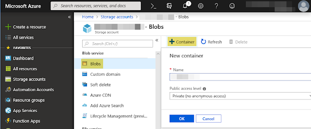

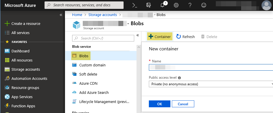

The next thing you'll do is open the newly created Storage Account, and then scroll down on the "things you can do with it" and locate "Blobs". You will create yourself a new blob, give it a name, like for example "backups" or just "blob". Take not of the name, as you will need it later.

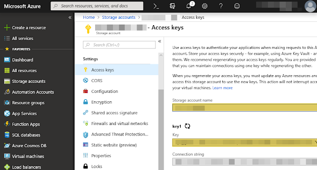

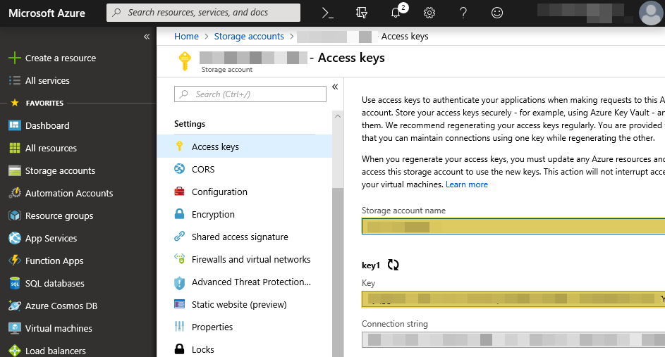

Then you will want to get the Access key. About the Access key, it needs to be kept as secret as possible, since it basically grants access to the things you put into this Storage Account. If you later worry that the key has been compromised, you can regenerate the Access key, but then your own routines will have to get updated as well. There are some other ways to secure usage of the Storage Account, but for the sake of simplicity I am using the Access key in this example.
And now you are set. That entire thing literally takes just a few minutes, if the Azure Portal behaves and you didn't mess anything up.
