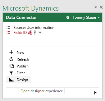

You can either start off with opening Excel, install the Dynamics Office Add-in and connect it to the target instance. Or you can open the list of users directly on the instance, and open the list in Excel from there. Either way you should start with a view where you have the System User list in your spreadsheet.
The next step is to modify the Design of the view. Click the Design link first.
