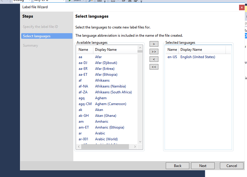

Add new label file like below image... In my demo I am Creating Extension of Sys Label file.
In Extension use Prefix of Existing Label File name then Add _Extension as Postfix
In my case file name was Sys_Extension. Now click on Add button and complete the wizard.
Select the Language is in use by Parent Label file and click on next ...
You can create new Label and override the existing one, For Demo purpose I have created Two Label @SYS456 which is New Label and the second I created @SYS12 which is already Exists in SYS Label File... We Created this one to override the existing Label.

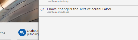

To handle Override case, I have created class for the verification...
class SLD_DemoClass
public static void main(Args _args)
info(SysLabel::labelId2String2(literalstr('@SYS12'), 'en-US'));
info(SysLabel::labelId2String2(literalstr('@SYS456'), 'en-US'));
